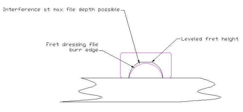

Hesh, you probably know this but when you level the frets you take off the top of the crown radius. there fore recrowning is more dessing the side of the crown radius to return it to a smooth arc. I like using half radius dressing files for this reaon. The half radius files allow you to file from the sides toward the top there by not affecting the the leveled fret height. Filing straight down with a full radiused fret file that is slightly larger than the fret radius can contact the top of the fret first there by messing up your leveling.

PostPosted: Tue Feb 28, 2006 6:35 am
If you mark a line you can watch your filing progression and stop before contact. You can watch the line caused by the filling marks with out marking a line but it is hard to see in some lighting situations. Anyway here is a rough sketch of what can possibly happen when using a dressing file if you don't watch the line.
